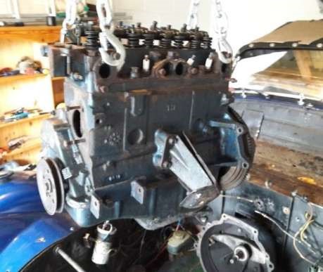

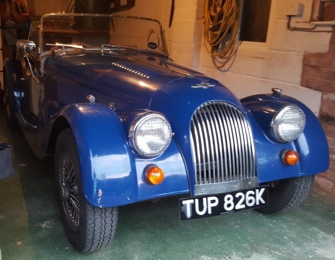

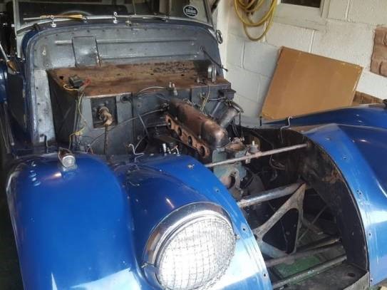

Please see first images of TUP restoration project - many more to come
